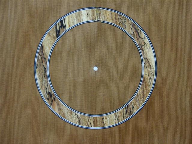

I use my Laminate trimmer for my latest rosettes and I just got a 1/8" to 1/4" sleave for the trimmer.
I thought the channel came out very well. I was certainly happy with it.
I used the 1/8" bit to cut the spaulted maple as well as the channel, than I had to route out one of the purfling strips next to the maple and I used the 1/32" bit to do that. I got right up to the maple and right up to the outer purfling line and it went perfect.
This is in the circle cutter jig I made from Tony K's post a while back Circle cutter
Rod True39042.9378240741

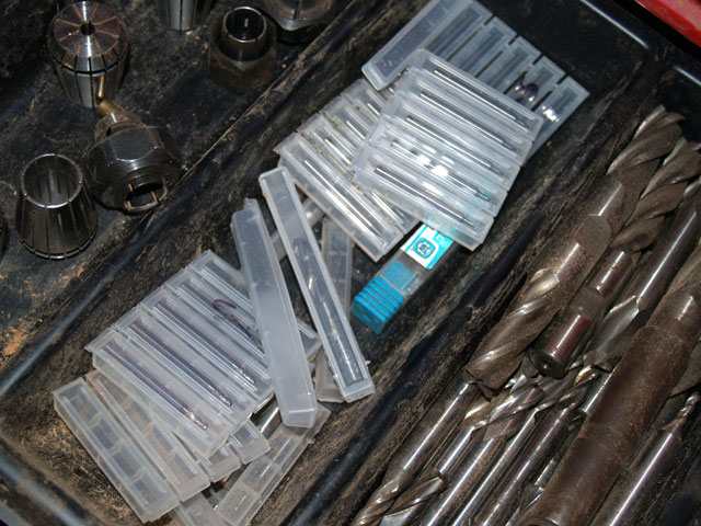

I would suggest an opposite approach, Lance. I think it's better to keep a dozen of the same cutter on hand and learn how many cuts you'll get out of them. That way, you can chuck it right before problems begin and grab another one.
I know I've suggested this many times, but find your local tooling guy. Ask any machine shop who he is and get your stuff from him. You'll get better cutters and save a lot of money. This is about a two month supply of little cutters for me, and the cost for this lot is about two cases of beer. They are all four flute up-cut carbide end mills.
John Watkins
CNC Guitar Parts
